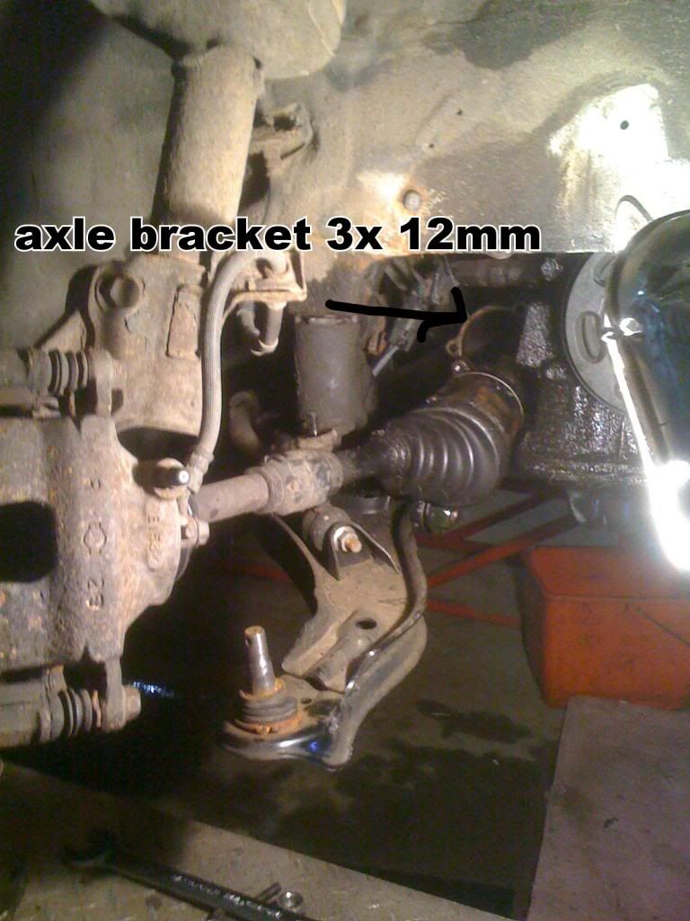

First jack up the car nice and high more space the better remove passenger side wheel and the plastic cover
Remove both belts ac and serpentine(loosen the alternator push it forward)
you should now be able to see the bottom of the pump
but the passenger side axle is in the way so (not having an socket that fits the axle)
I separated the ball joint and unbolted the sway bar link. also you must unbolt the axle from the bracket
slowly separate from bracket 2 MAN JOB pulling the strut out and strap it back with some wire.

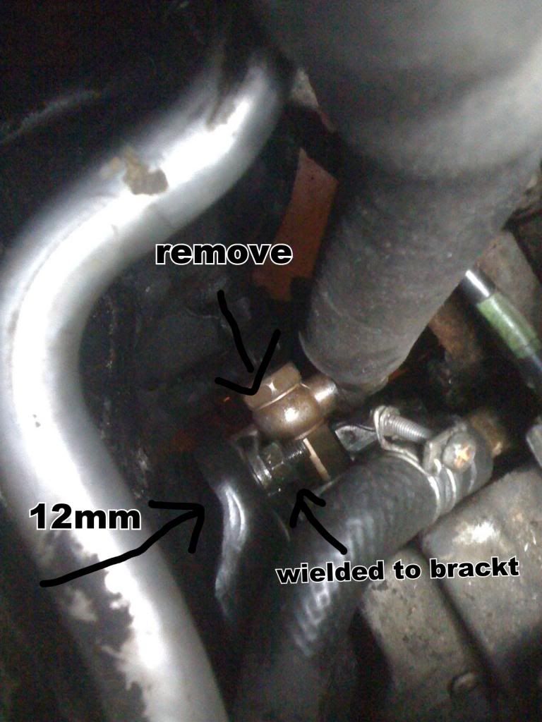

on the top side
remove the banjo fitting before unbolting the pump also if you do not have
new copper washers do not lose them or damage them
along with the reservoir line.
and the one bolt holding pump onto bracket 12mm the ones a pain to get at. being so close to inner fender
Removing the pump with the lower bracket attached is the only option because the bolt that goes through the pump is to long and can
not be removed being blocked from the inner fender. but it will fit through the larger space, reinstalling just do the reverse,
