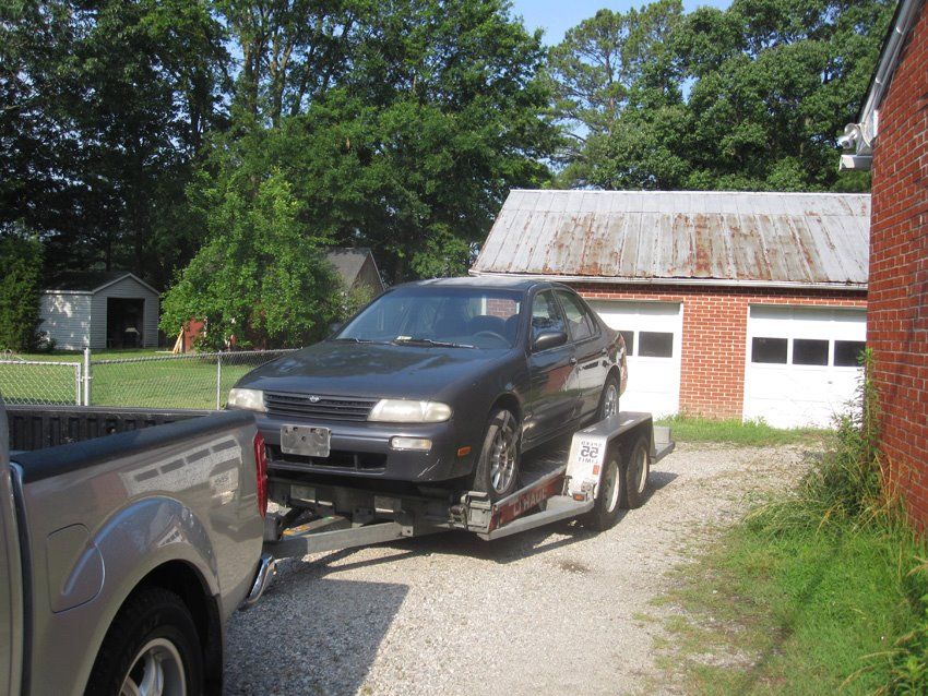

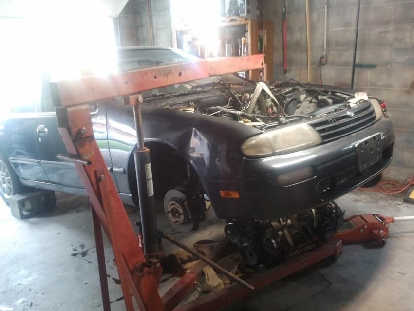

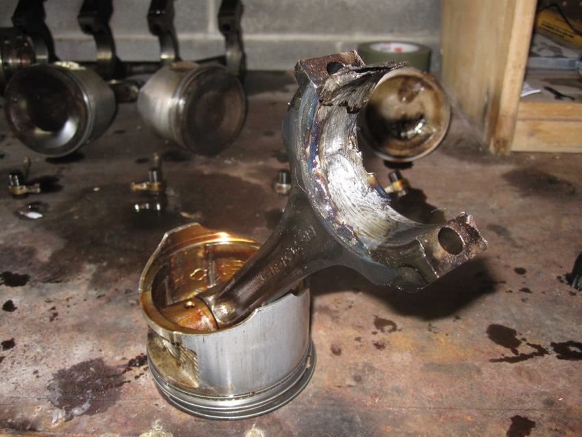

$500 Donor car (aka the blue waffle) with seized engine. Threw in the running 98 engine in it and used as a daily driver while the other one slowly got put together
Trying something new...from the bottom.
AT -> MT
Block tanked, bored, assembled, and painted
