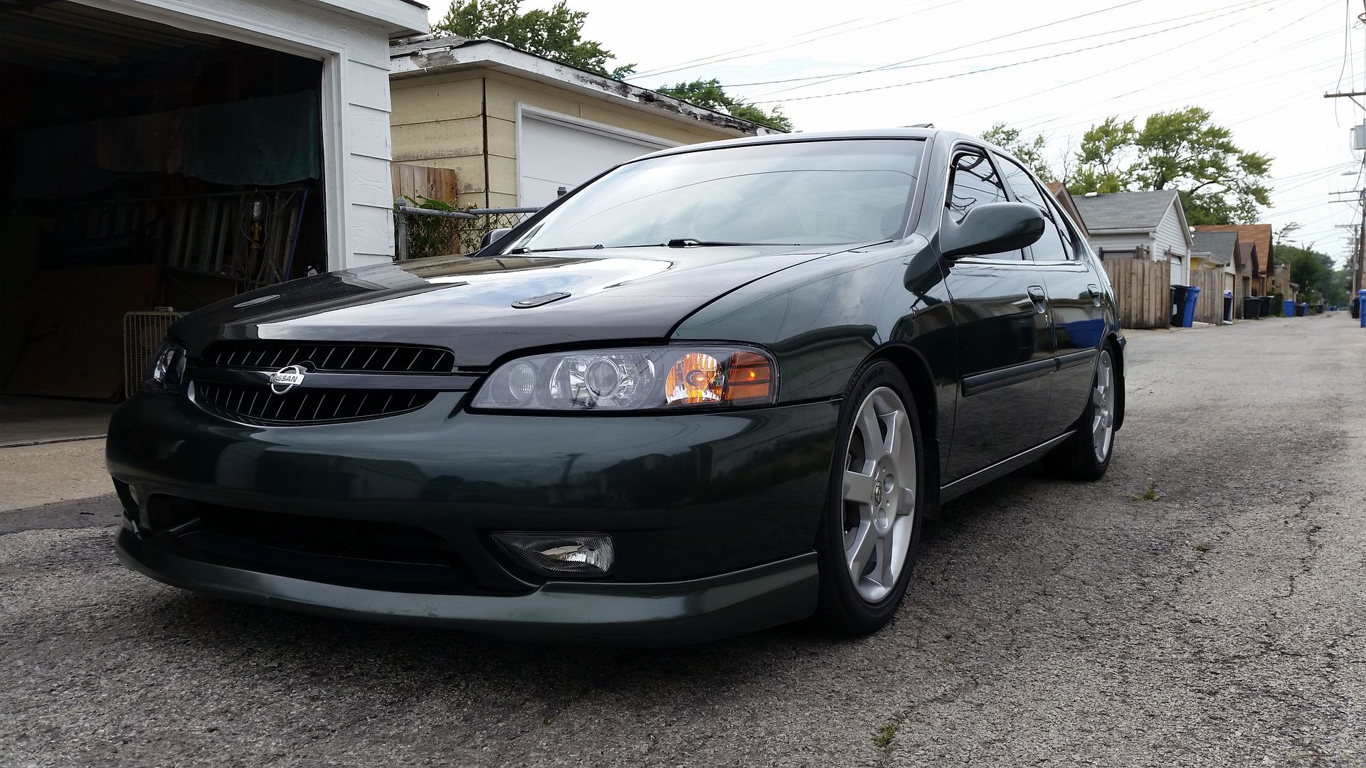

2000 Nissan Altima GXE (Amanda)
Green Emerald Metallic/ True Green Metallic
Got her 12/02/09
Mileage was around 81k
Current Mileage is just over 108k (my daily driver)
How she sat bone stock back in 2009
How she sat on September 2014
How she sits as of September 2015

The moment we all been waiting for, after shots of her on the ground!
After shot of distance from ground to wheel well (same on all four corners, it only took me one try, and it was during installation, winning!)
After distance from ground to front lip.
Last shot of her on steelies.
Looking a hell of a lot better with the Spec V’s!
Overall it was just about a 2” drop from stock height.
Note: I did have to roll the rear quarter panels to EVEN fit the OEM steelies. There was barely a finger gap between the quarter and tire before the roll.
