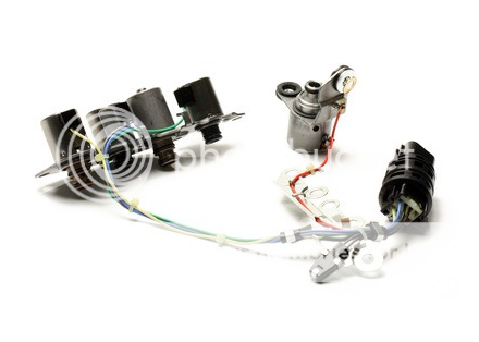

Im trying to remove the bolts but I cant seem to get any tool back there. There are 4 bolts holding the Solenoid Valve Assembly in the picture on the left. Any one have any experience on what combination of tools to get back there. Seems the transmission casing is in the way. Thanks!

The control valve assembly AT-306 shows the component parts. The next page shows a side view with 7 bolt length types and the number of bolts for each type. All the bolts are lettered but they are very easy to misread the letters you have to be careful of which ones to remove. As usual the Nissan factory service manual is a bit confusing as to how remove what and when.
