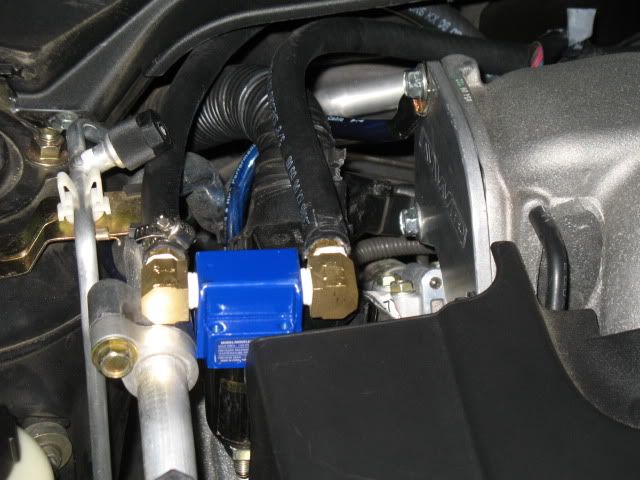

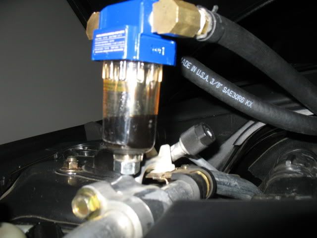

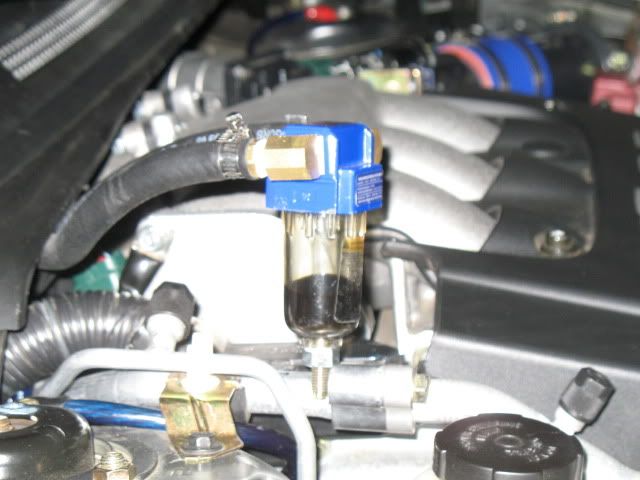

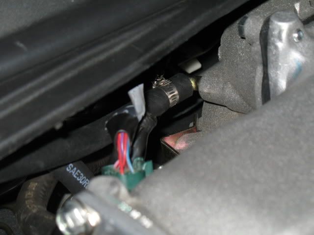

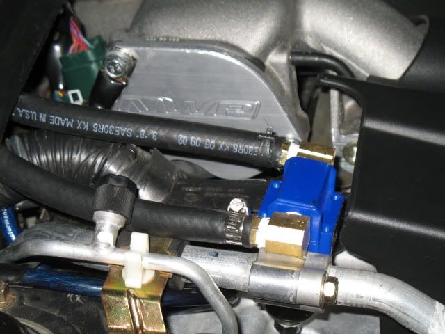

Heres my catch can setup. Basically the same with the husky air tools oil catch insead. And yes, the QR's produce plenty of oil. I dump mine about once every two weeks. I also used hose from a clothes washer fill hose because they are red. I had to line them with 3/8 aluminum tubing because the hose was collapsing. Now it's working great. I also cut the original hose and put in a 3/8 barb to barb at the pcv and flipped my IM bung.

I would think you'd loose a certain amount of draw as you get longer hose length. That's why I tried to keep my length to a minimum. I saw where you posted about the PCV, did you have any questions about that? The valve just unscrews at the rear of the valve cover with a 23mm wrench, and the mount on the upper IM is just 2 10mm screws to take it out. I just unscrewed it and reversed/flipped it.

PM replied, but I thought I'd post here since you asked the same question, and to help others. Look at this pic. All I did was loosen the 2 10mm bolts holding down the spark plug loom, unplugged the spark plug wires, and moved them out of the way. Then the valve is sittin right there in front of ya. Takes a 23mm wrench. If it's tightened to a point to where you can't fit a wrench between the tight walls of the valvecover around it because it's kinda recessed, then you may need to get a 23mm deep socket and loosen it that way.
